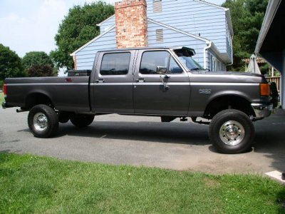

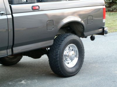

I don't think you can beat the factory Alcoa's for the best look...but I'm biased :flipa
I second that. Ford does have some of the nicest factory designs.
I went back to factory wheels on my PSD instead of aftermarket.
