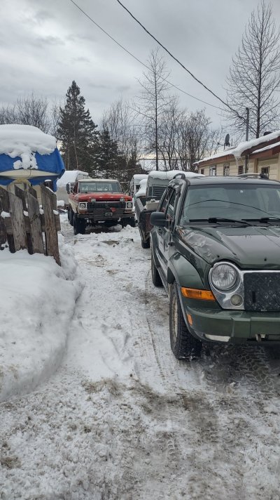

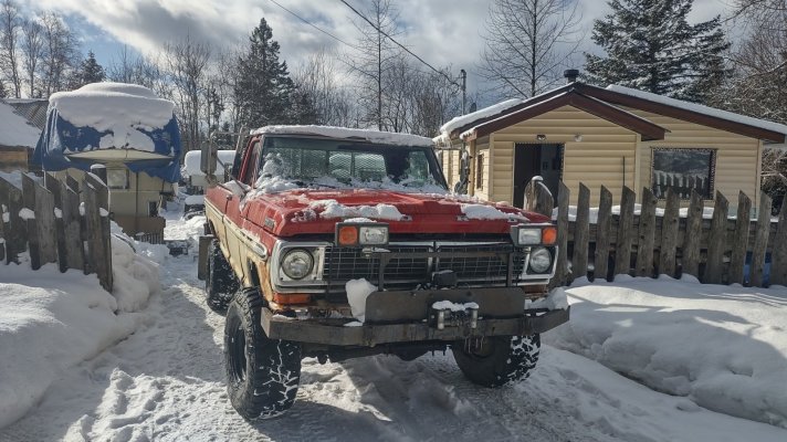

Something I noticed, stock ujoints are Spicer 5-153x. And fit Jeep Liberty limited edion diesel vehicles too. Just a thought
