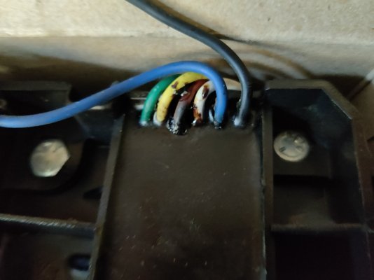

Finally got to this -- 6 bad glow plugs -- (could not start when temperatures dropped) but controller showed signs of overheating with burn marks on 2 of the wires -- eventually wait to start light came on bright and steady while driving. Replaced all plugs + controller -- system back to normal.

Glad to hear it!
Can you send a pic of the fried GP controller. Just hit attach file located at the bottom of the editing/reply box. Or copy on your pc and paste in the editing/reply box.
