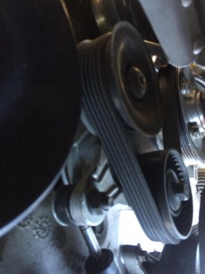

There is no down time with the green machine that is for sure , 1/2 of my V belt was riding on the clutch fan pulley so i went and bought the tensioner pulley assembly and new belt made by Dyco . Installed every thing and now the belt doing the same thing slowly sliding out of the tensioner pulley and making clinking noise which wasn't present before ..
The only noise i had previously was low squeaky belt every now and then.
The rest of the pulleys looks pretty straight and lined up with no bents . I could order the OEM if this brand which locally made is no good , What else i need to check
