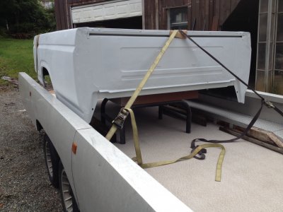

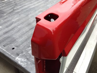

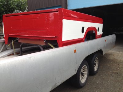

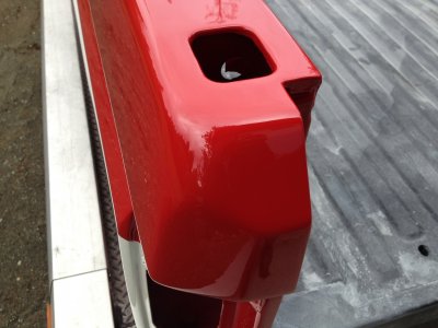

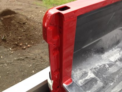

Well guys, its out of my hands now. I just dropped the box off at the painter's.
david85
Feb 21, 2008
4,953
1,244
Campbell River, B.C.

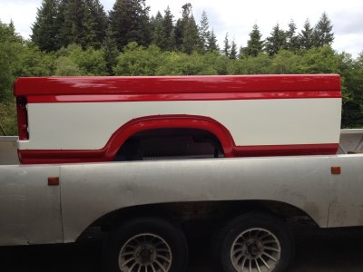

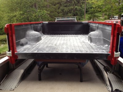

Here it is. Looks like he forgot the rock guard at the bottom edge. No biggie, he said he can do it later once the truck is back together. That still seems like a long way off though.
...now I just need to psych myself up and tear into the cab. Last hurdle. Last hurdle....

WOW!!! That is better than new!!!! Looks really good. This truck is going to look really nice when it's done!!!!
But, on a side note, what is the story with the trailer?????
david85
Feb 21, 2008
4,953
1,244

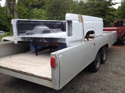

LOL I was waiting for it. Yeah its pretty bashed and dented after all these years but it still gets more comments than anything else I've driven or towed. Even the guys that helped us load the box at the painter's shop were more interested in the trailer.
Its 100% aluminum except for the steel running gear and pressure treated plywood deck. I designed it in AutoCAD and we built it from scratch years ago to haul railings long distance to and from the powder coating shop (100 miles away). Way easier and safer than throwing them on a truck headache rack. It also helped reduce fuel consumption for larger loads since frontal area was not added to the truck.
The curved side panels are simply 1/16" aluminum sheet that were ordered pre-bent to snap onto the upper and lower frames of the trailer structure. A few set screws then hold them in place. Not sure where the turbine rims came from but they look nice with the raw metal. The wheel arch was formed by making a frame behind that was strong enough to bash a fold into place with a rubber mallet. Turned out pretty good for a first try.

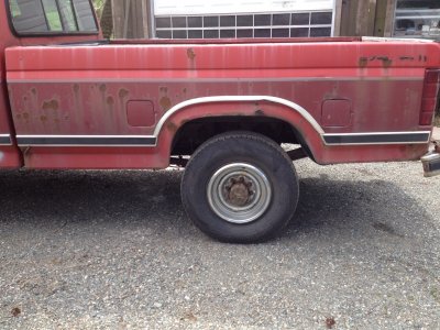

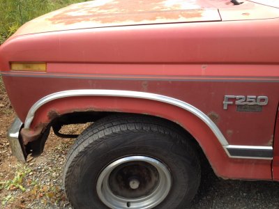

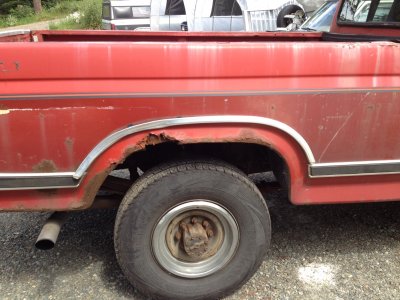

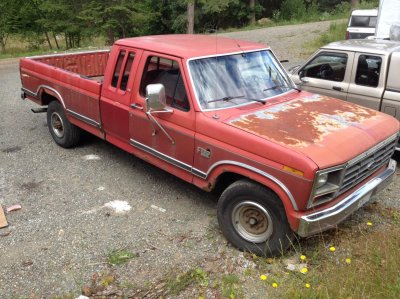

One last look before it all gets torn apart. As I said before, its been through a lot, and it shows.

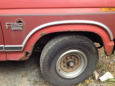

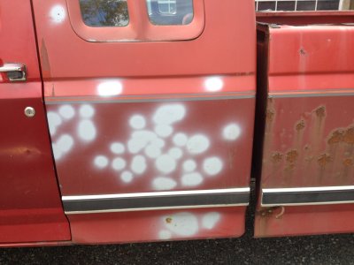

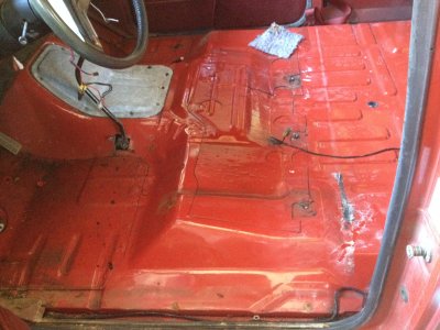

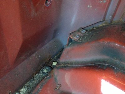

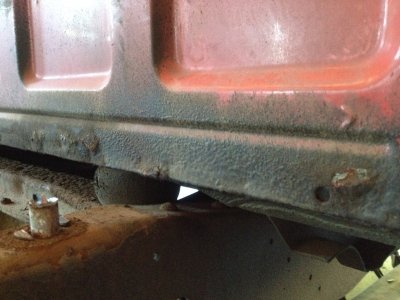

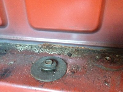

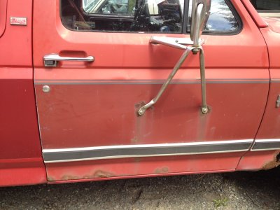

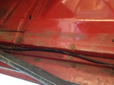

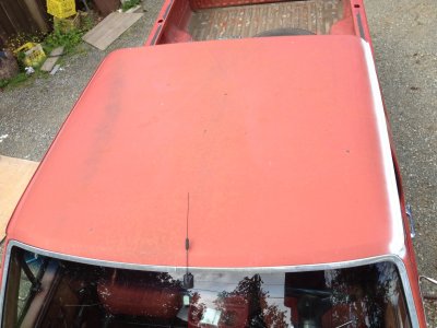

The windshield started leaking nearly a year ago but got much worse in the last few months. Its wet under the carpet, but every time I peel it back, all I see is shiny red factory paint. Here's to hoping.
david85
Feb 21, 2008
4,953
1,244

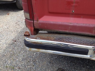

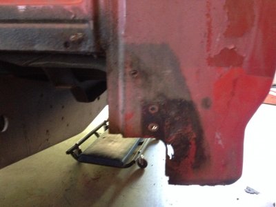

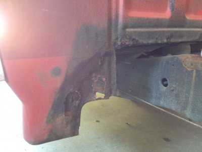

Cab looks pretty good. I will need to replace all the sheet metal at the bottom rear wall where it joins the floor but that won't be too bad. None of it really has to look pretty like a fender. The floors are good except for the mounts for the rear bench. The underfloor reinforcing always traps crud against the floor pan, so that may have to be removed. Its still solid but I don't want to tear it down again. The one last "known unknown" is the cab extension under all that cracked bondo. Hopefully it didn't rust through, but I'll find out soon enough.
Oh, and the carpet was a real pig to get out. It was wet, as expected. So even with all that water trapped underneath, I dodged a real bullet!

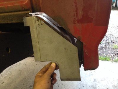

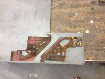

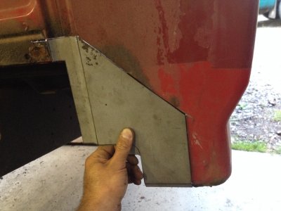

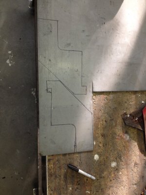

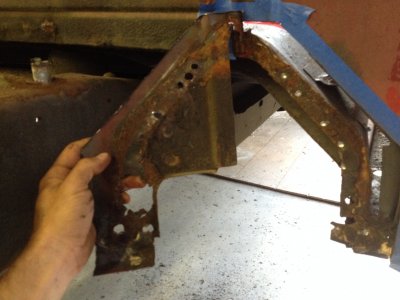

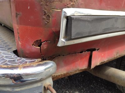

More tin bashing...
I'll repair both cab corners before cutting out the rear bottom wall. That way nothing gets shifted out of alignment.
Rather than make a template, I simply pounded the cutouts flat and traced. Worked pretty good and one is almost ready for welding.
Still have to clean up the rust in the rear floor and beam though.
