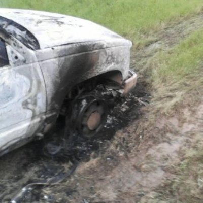

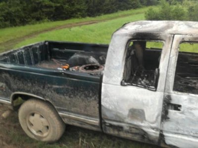

not tryin to thread jack.i know its not an idi or even a ford but its on the subject of burnt trucks.mine burnt last Monday.something behind the back seat caught on fire.idk what.but I got motivated to try an finish my idi after this.btw sorry about your.youll have her goin in no time
