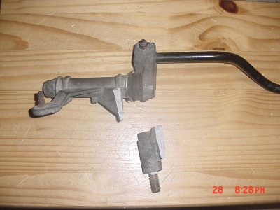

This happened to mine today!! I was backing up the trailer and went to put it in 4 low and the shifter knob came off in my hand. I ended up getting mine out of low by parking the truck on a level surface and blocking the wheels, unlocked the front hubs, and put the truck in neutral. I then pulled the front linkage off the shifter, then pushed linkage towards the back of the truck and it poped into 2 hi really easy. I think what happened was the bolt that the bracket pivots on rusted/corroded to the bracket. Here is a picture of where it broke.

Yup, that's exactly where mine broke. Thanks for the ideas, I'll go out and give them a shot. Thanks.
