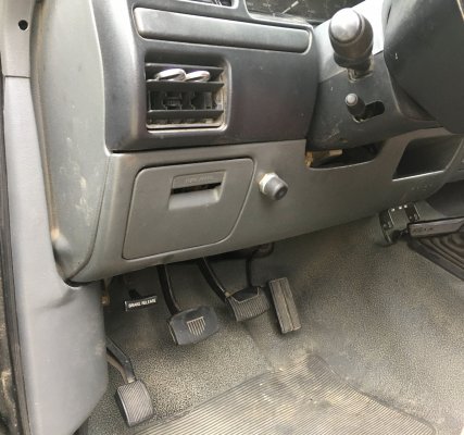

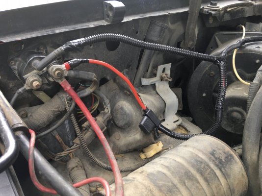

Finally fixed here. Replaced key lock cylinder and no change. Wired a push button in with hot from battery side of starter relay and spliced in the connector to the top small post on relay.
Knew I did not have the skill to take the column apart to fix the actuator.
Worked a few times then would not start/no crank. Ran 12V to solenoid on starter and it worked fine. 12V to small top post on starter relay just clicked, no crank. Then replaced the old Motocraft starter relay with new one from Ford dealer and all works perfect.
Great to have it rolling.
Appreciate everyone's help, learned a lot. Fortunately I had time to work through this frustracting set of issues.
