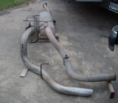

regarding the exhaust - A few guys have cut and welded a +99 exhaust to fit, but they are not a bolt in. The +99 is a 3.5" system.
Some of the problems I remember when I tried it:
1. The rear hanger needs to be moved.
2. The exhaust gets really close to the spare tire. Part of the problem is the shock location is different than ours which affects the exhaust when it goes over the axle.
3. The muffler is huge and will hang way down.
Here are some photos of a 2000 or 2001 (don't remember the year for sure) next to a stock 1991.

im looking for aftermarket bolt on, like a 4" if not i ma repair my old exhaust and bolt her back on, if there arent any
my trucks spare tire has been relocated...long story there
i found the hypermax exhaust i have for $225 its a 3.5" system
