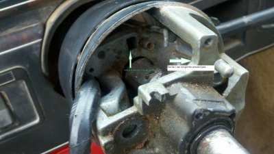

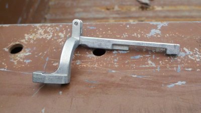

I have as you see taken apart my steering and need to replace the actuator. How do I fit the actuator into there? I tried every wiggle way possible and I can not fit it in. Thanks.

It does. It basically led me to what I didn't want to do, which is tear everything apart just for a piece of pot metal.
I went to see if I could get one made from a CNC and the guy quoted me about $100. I am gonna try a few other places with the 3-D laser scanning. There is no reason it should have been made so cheaply.

Do some searching around, I know I came across thread somewhere or a video on youtube that showed some way of replacing the actuator without doing all of that. It involved trimming some of the metal off of the actuator. I dont remember where I read this, sorry I cant be of more help

Had mine fail the same way, AFAIK they all do. I put in pushbutton starter to keep from torque'ing it again. Too bad some machinist wont make us one *hint hint* :sly;Sweet
