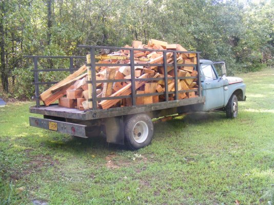

I heat my house with wood (and propane as backup). The wood blocks come from a sawmill 7 miles away for $35 a ton. They used to fill my IDI or even my F-350 flatbed for $50 (sort of still counts as a "pickup load") until they figured out they could make more money scaling it. So my cost for 2.5 tons (in the F-350) doubled... still much cheaper than propane.
During the Arctic air cold wave all last week, though, I made many trips to the basement feeding the furnace in single-digit temps. Got some exercise, anyway...
Do you have photos of these blocks?

Blocks like that used to be easy firewood around here also, then a major wood pellet manufacturer built a factory. They buy up all of the scrap lumber and grind it for making wood pellets.

Love that body style. Is that one a 65 or 66?
James
It's a '65. The F-350 didn't change (like the F-100 and 250 did in '66) until '67 though. Extra attention is required when buying parts, as most catalogs show 100 or 250 ;)
