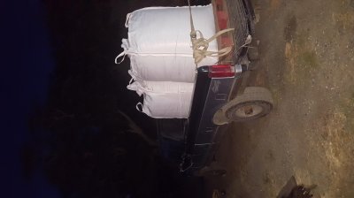

The old truck will be getting a little workout hauling soil these next few days.

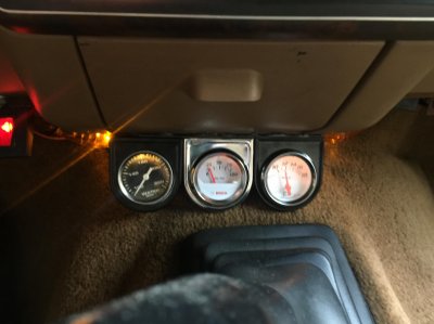

Gauges all finished up in the idi. Truck wasn't running so bad picture. Water is "mechanical" volt meter is a volt meter and oil pressure is electric.
Finished them up in the 150 as well. Still gotta clean some wires. Water is electrical sender (really cool I like it better than my mechanical in the idi) volt is volts and oil is mechanical with a copper line.
I also put a Napa coolant filter on the 150 just like I did the idi and put my electrical water temp sender spliced in the plumbing of that. Figured it can't hurt to keep this truck mint with a coolant filter even though it's a gasser.
Now all that's left is to do the 250, but idk if I want to see my oil pressure on it hitting 200k soon.. Haha it's staring at me every time I walk by it and I have the gauges already so I guess I should do it, probably warrants having the gauges more than the other two trucks based of mileage and condition but it's way too hot out so not happening today.

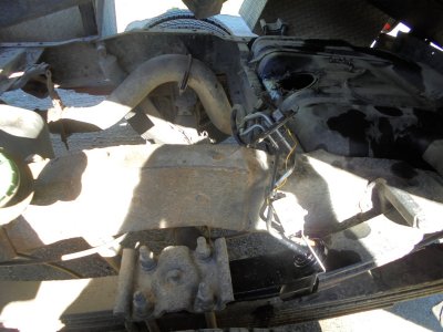

ok so i recently installed a new fuel tank sending unit assembly in my rear tank.i used it last week and ran the rear tank out of fuel while going up a steep hill with the gauge showing 1/8 of a tank still.

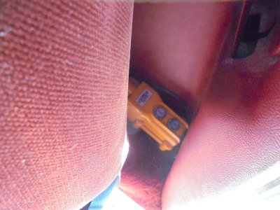

so today i fixed this.it was such a hard chore you guys.you know just accessing the sending unit.i mean i had to press this up button as shown here.get this.....for a whole 5 seconds just to get the bed up where i needed it!!! oh what a hassle!
attachment.php

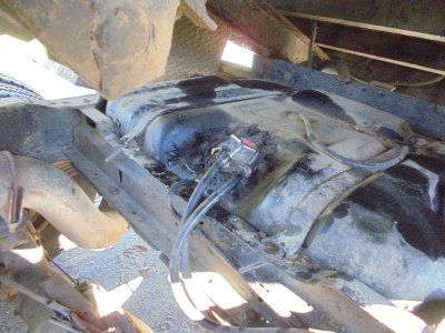

next i had to remove these screws.it took 2 minutes!
attachment.php
now that it's out i bend the rod up a bit.re-installed and went down to the fuel up.so i eased in 1 gallon and now i see it come up nice off E.so i give it one more gallon and now it's showing just off E.i might bend it a little more but i think this is good as E now = 2 gallons left.so now i wont risking running the ip dry again.once down around E i can just switch tanks and keep on trucking.
oh what a job! start to finish i think it took a whole 10 minutes! im exhausted!:D
attachment.php
you can see my frame repair,done last year here in these pics too.frame cracked right straight up above both wheels.they welded the seams back up,plated,welded and bolted those on.so now the frame is stronger than it was there.i haul a crap load in this bed and dump every day.sometimes multiple dumps per day.
