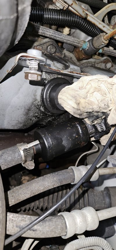

ok so the 1993 no turbo 7.3 valve cover to cdr grommet looks like this pic{ below from my fone} however the internet only lists this thing with no specs given by ferd...
we list 2 pn's e8tz-6a892-a
e3tz-6a-892-a
neither look like my pic below...

They are cut to spec for the valve cover option. Same part in my experience.

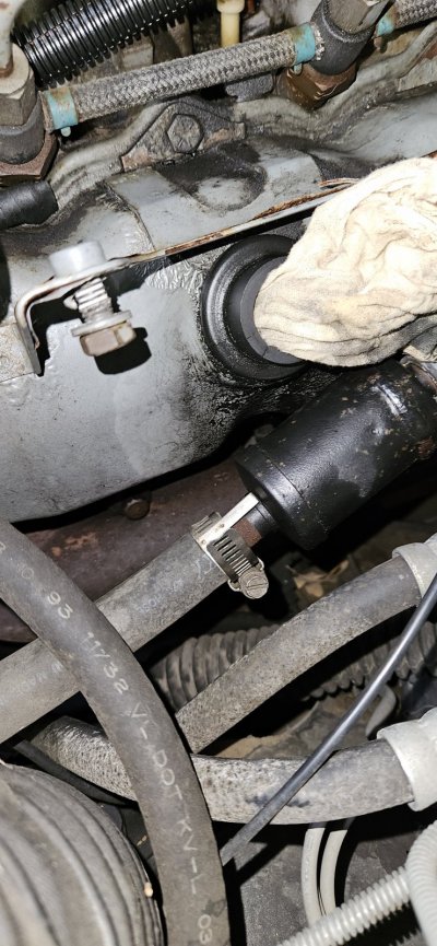

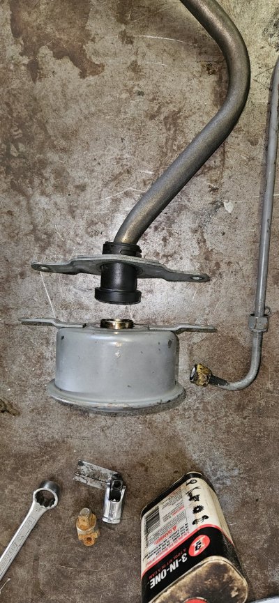

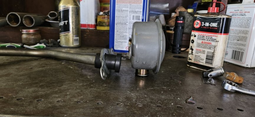

So what is the litte flat one for? The outlet look like this pic...
Ford had a better idea then fell asleap?!
Yea lets package 2 different applications in 1 box and save $$$?
Thanks fer lookin
4,209
4,793
The flat one is for the o ring for the cdr if it was bolted to the back of the intake instead of valve cover arrangement

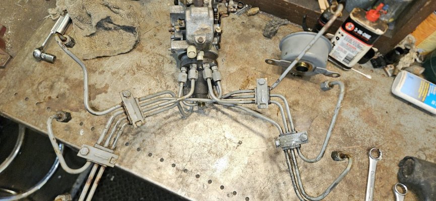

Here's some 60k ugliness...
Plus it also seal the tube that connects the CDR with the air intake to the CDR itself on Factory Turbo applications. In the pictures in CLB's post #21, it goes where the wider part of the CDR tube is at. Between the CDR and that plate (for lack of a better term).

What ugliness? Looks super clean. Just dont send Anything UPS.

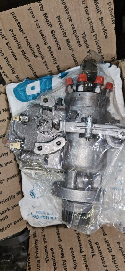

Normally
I'm with you on that.
However
They came thru this time

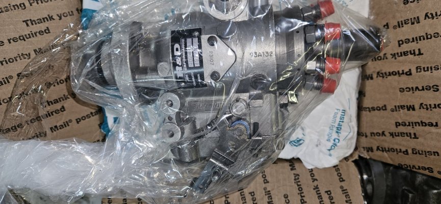

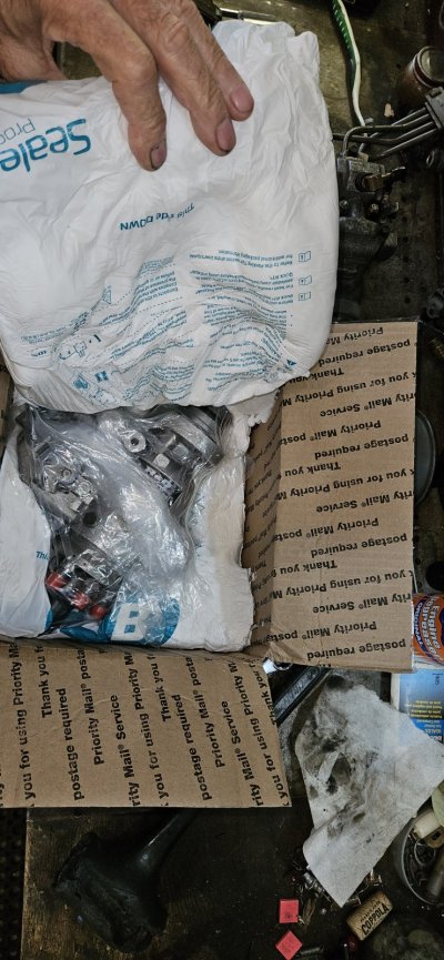

4,209
4,793
Ooh now there's some pretty parts. Can't quite read it with the glare on the plastic, is that the 80?
Clb
Another old truck
Mar 1, 2013
6,953
3,351
nannyfornia
80
Justin is now building the 90 calibration into the 80 pumps.
4,209
4,793
Oh heck yeah! My 90 didnt come with that note, but I also have no desire to turn it down. She scoots with it at 90!

Not positive BUT...
The internals are now different don't try that without verification of build date and calibration on older builds.
I've been getting 8.5-9 mpg, not even worried about power anymore...
