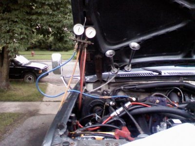

today, from my father-in-law. i don't know if it's a good thing or a bad thing yet. because now i have it and that means i have to do the work from now on.... now how long do i need to keep the system at -28hg before i fill it?

that reading is just the system with the pump shut off. been holding it for about two hours now. how long till i can fill it?

it is best to let pump run for up to 12 hours if you have not replaced accumulator-drier assy that way no moisture will be present in system other wise moisture and r-12 or r134a becomes hydrofloric acid and that will do your system no good

Suck the system down then close the gauges and let it sit a half hour , if it holds the vacuum, you should be leak free, then continue vacuuming to remove moisture, best overnight.

yep the vacuum held overnight :hail. running the pump for the next 10 hours. didn't run it last night because i didn't have the proper oil. i do now. thanks to everyone for the help

12 hour run is a bit over kill no? Being in the business, a one hour run is just fine. Since you have established that there are no leaks, as soon as you have the vacumm as low as it will go(one hour period). Weigh the charge in immeditely when done, that way if your houses/gauges have any very small leaks you will not be reintroducing an air/moisture to the system. In other worsd, don't just let it sit with the gauges on it doing nothing, you will have a cleaner system doing this.
