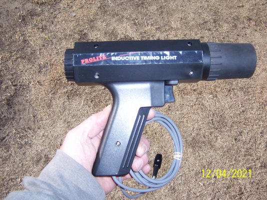

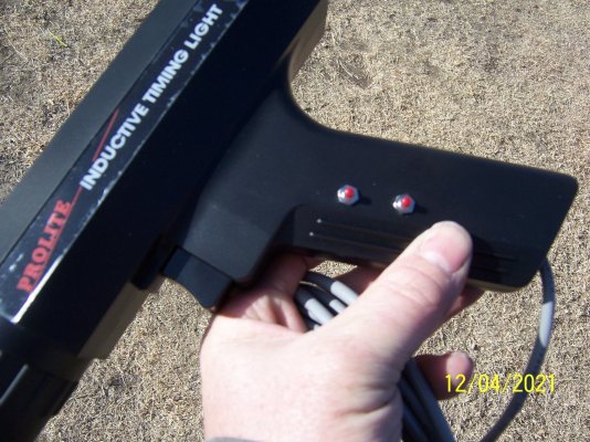

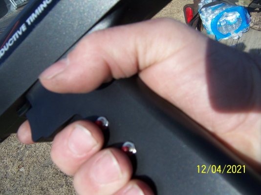

I can't believe that I actually remembered this, but I did take some pictures of the DTI timing light for Big Bart and anyone else who may be interested. On one side, it looks normal. On the other side, you can see the advance and retard buttons. In the third picture, I'm trying to show how to use this light with one hand. Index finger on the trigger, middle finger on one button, ring finger on the other button. It's truly a one hand operation to run this light and "move" the mark on the balancer. If you put a turnbuckle on the throttle part of the IP, then it's a one hand operation to check the timing. You still need both hands to move the IP, but the checking itself doesn't. THIS is why I felt that it was worth it to buy this expensive light.
