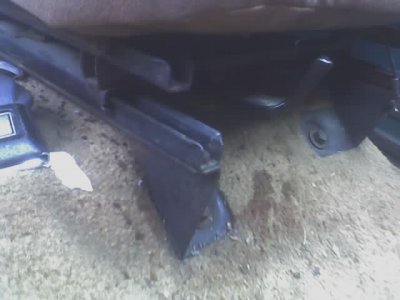

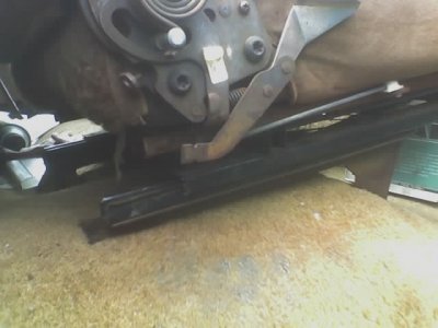

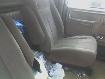

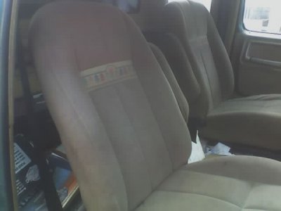

i have a set of EB buckets out of a Bronc installed in the ugly green truck. only one hole lined up from the bench holes. the rest were drilled and reinforced. very comfortable seats. too bad the rest of the truck body was massaged to death by death by cattle fiending for stale "hostess" snack products.

How did you reinforce? Assuming I'll need to do the same?
i just put in thicker pieces of metal. each was drilled and formed for the floor contour. the thickness doesn't have to be obscene, but you are your own judge for safety. if you not a "big guy" the reinforcement doesn't need to be that thick. I fall into the "big guy" category, therefore I used a little thicker metal.

I assume based on the pictures of your mounts that the reinforcement is under the carpet? Or did you have to manufacture the angled mounts as well?
