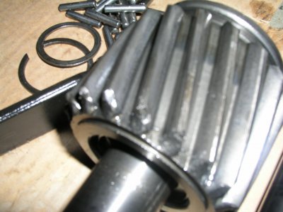

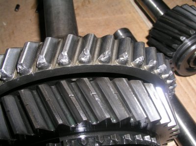

This is from my recent T19 project... As you can see, the idler gear as well as the reverse gear are pretty chewed up from somebody slamming it into reverse. All the other gears look good. What I am thinking- maybe ramp the idler gear to smooth it out a little as it looks like the reverse gear actually meshes towards the middle, not on the edge. I am thinking the reverse gear is trash though. It would not take much to convince me to replace both. What say you OilBurners? Run it as is or no?
Also, anybody know of a cheap parts source for tranny internals? The cheapest I can find is at least $100 for each gear and that seems high. Thanks

The idler gear cannot be reversed because it is different on one side from the other. The reverse gear prolly could but I am hesitant to do so because some of the chips go about 1/3 of the gear and the way I see it is that I lost that much strength since the heat treatment is only good for a couple millimeters.

Replace them both. With that much damage, you will eventually have cracks form in the gear body itself and thats the kind of thing that will leave you stranded or trash the rest of the tranny. I would not trust a transmission with internals like that and you will never have peace of mind on longer trips from home.
everything else looks really good with the exception of the output bearing, a normal wear item. The magnet did a good job of picking up all the chunks too.

Sorry, just to be clear, I meant to replace the gears that are damaged, not the whole transmission. The rest of the internals can be inspected and reused if no damage is found. I think you can salvage the tranny, but considering the cost of new parts, you might just keep an eye out for a used replacement. Sometimes they can go for under $200.
