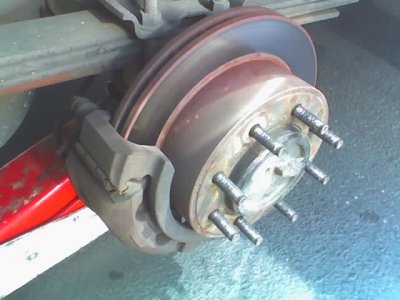

here's a pic on a E350 SRW witht discs. rotors are a slip-off to the axle. they also come in DRW too;Sweet Pricey? yup. figure the cost for a axle before mods is going to be $500-$700. But the parts availability is good for the peace of mind when having to work on it.
From what I see it looks to me that that is a semi floating rear axle and not a full floater. Am I correct?
1,442
the srw's are semi floats. the drw's are full's. We know the rims are the same between the vanner and the pickup, so the fitment is not the issue. I'm not suggesting using the whole axle, just the brake parts. problem is, I don't know of a single full service wrecking yard that will part out a perfectly good axle.
