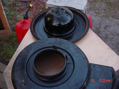

The soup bowl in the Raywell and the Banks kits isn't as deep or as big in diameter and therefore isn't the obstruction that it is in the stock lid. It is intended to reduce the volume inside the air cleaner and direct the airflow into the intake. It also allows fror about an inch taller filter, which would add about 30 square inches (about a 15% increase) of filter surface area to make it breathe easier. Whether it actually works or not, I can't say, never got around to trying it before I sold my NA truck - and it won't work on my Turbo truck.

Mike, I'll swap ya a plain lid for that Ray-Wel? I've got 2, one with and one with out the soup bowl. let me know where to send it?
Well, after reading that, maybe I ought to rethink my putting a new lid on my truck....What would be cool I suppose would be to have a normal Ford air cleaner and mine and run them both on the dyno to see if there are any real differences.
I'm going to take the lid off, put a ruler on it and get some more pics. The bowl on mine *seems* like it's bigger than the one you showed in your pics.
I'm backing off on my statement about wanting to get rid of the bowl after reading Cheaper's comment and until I do some more checking waterdoc. If I stumble across one though I'll get in touch with you & figure out where to send it.
I'll take a pic of the baffle (for lack of a better word) that lived on top of the intake too. I assumed that was just blocking airflow. Maybe it worked in conjunction with the bowl to vortex the intake air or something? I wouldn't expect the way the air is coming in to have any impact on performance/mileage etc though...
