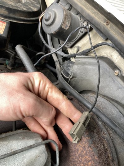

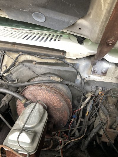

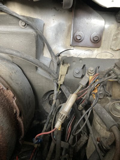

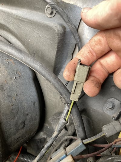

I have a two random wires on the drivers side firewall wondering if anyone knew what they were for. One is green with a yellow stripe. The other is black.

I think that the hood light wires use a connector like that one, but I'm pretty sure that it hooks to power, not ground. The hood is supposed to be grounded by it's own dedicated braided steel wire on the passenger's side.

Yes the hood has the braided ground strap. Those wires are just hanging in the breeze seems kind of random. Everything seems to be working. I was hoping one of them was for the coolant temp sender. I bought the truck 6 months ago and it seems like the truck never comes the C needle on the gauge. I replaced the sender and thermostat with a ford oem one. Checked the radiator cap and flushed the system with about 20 gallons of distilled water and charged it with the appropriate SCAs and antifreeze concentrate. It’s an aftermarket aluminum radiator I was wondering if it was too big and not allowing the engine to get up to temp, but that wouldn’t make sense if the thermostat was working properly. I plan on putting an aftermarket engine temp gauge because I hate not knowing what it is. The truck is a welding rig and never tows but I still don’t like it. I plan on putting a vacuum gauge as well.

A lot of money has been wasted over the years from someone troubleshooting using the factory gauges. If you are worried about your truck's health and well being, get a set of aftermarket gauges and use them.
Not sure what year truck you have, but in 1986 they did have a underhood courtesy lamp that was fed by a lightgreen/yellow wire with a black wire. The lightgreen/yellow feeds all the courtesy lights in the truck at the door jamb switches, the glovebox, and map lights if you have those options.

None of the wires for the factory gauges used a plug in line like your pictures show. The reason for the plug in this wire was to allow you to remove the hood while leaving the light attached. Assuming that it's for the hood light. I'll second the aftermarket gauges. You just can't trust the factory ones.
