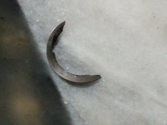

Well I opened the top of the fuel pump and found this laying in there???? It looks like half of a maybe 1 inch washer. Looks like its time to contact one of the members that rebuild idi IPs. Fuel pump was full of fuel. I checked the fuel solenoid with it off and it looks great and works when engergized.

,gallon jug up high above up, girl line to the IP inletbypass everything...where did ya find that ?
In the Top of ip you mean?
Ronw435
Mar 30, 2019
54
14
New Mexico
Yes I opened the top of the IP and found half of a large washer laying in there. IP was full of fuel. Called CDD and they said it will have to be rebuilt. I ordered a rebuilt IP and rebuilt injectors coming from CDD.

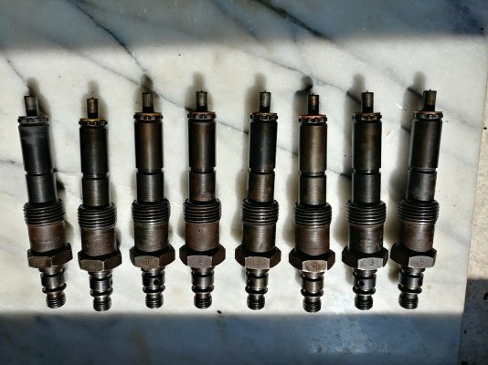

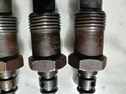

Well I pulled the pump and injectors today. The injectors seemed awful clean. All I have done is wipe them off with a paper towel. Also all the injectors had the letter E stamped on them except one. It had a D. Can someone tell me what the letters mean?

Those were codes for the different types of injectors when they were new. After being rebuilt, those letters really mean nothing. Each rebuilder sets them to his/her preferred specs, not what Stanadyne set them to.
