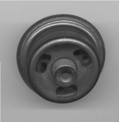

342
You need a new t'tsat, only IH or Motorcraft. It has to look like this.

682
Be extra careful buying a thermostat. The chinese crap looks really close to the oem stats. But they have all broken too. Those metal brackets on top of them break and then it wont open or close causing a possible meltdown. Because its a deep area to remove the stat I can't understand why some will buy crap and end up doing this job twice. But money talks... Only the Ford or International dealer is the place to know your getting the right thermostat...
