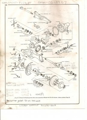

I replaced my leaf springs with new ones four years ago. I replaced everything: ball joints, shackle bushings, axle pivot bushings. My camber was positive. I had Les Schwab do the alignment. The maximum adjustable camber bushing available was 2.75 degrees. After installing at max my camber was still about one degree positive. I was told the new springs would settle and my camber would get close after a year of driving on our crappy roads. I haven't rechecked, but tire wear is not an issue. The camber adjusting bushing is on top of your axle housing, With a 1 1/8 nut if I recall and a cotter pin. The nut is threaded onto your upper ball joint. Just as a comparison I have about 1 5/8" between my bump stop and axle.
