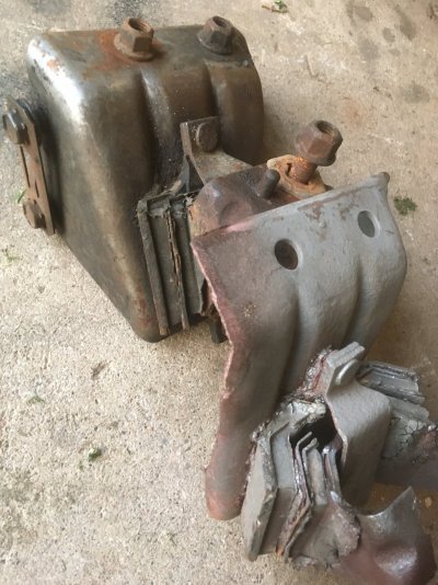

Some years later and back on the east coast, my mitsubishi diesel ranger build is getting started. Thinking motor mounts in here:
But these are 2wd mounts:
Perhaps engine comes from here or the rebuilt 55t from a ford I just acquired:

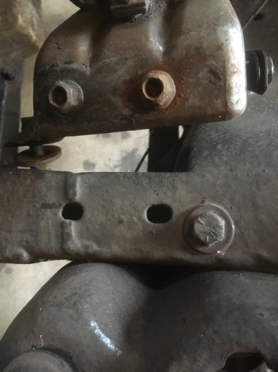

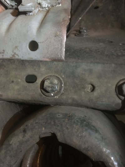

Have you tried putting the mounts in yet?
oof.
I don't see how you could have gotten the two wheel drive mounts in the 4wd unmodified. The engine cross members of both the '87 4x4 and the '85 4x4 I have interfere with the motor mounting bracket from the 2wd diesel. Allthough less so on the '87. clearly there's different cross members. And the locator hole next the bolt holes are oriented opposite on the bracket-less side.
More cut and weld then.

david85
Feb 21, 2008
4,953
1,244
Campbell River, B.C.
Tell you the truth, it's been so long, I have a hard time remembering all the different mods needed to make the conversion happen. There might have been some modification now that I think about it. If I remember when I get off work tomorrow, I'll see if I can get a snap of the mount in the truck.
Vern
Jul 12, 2018
150
32
Albert NB
Thanks I'd appreciate that very much. In any case I'm modifying the mounts but I'd like them to be bolt out removable is all. For quick cut of losses. lol
