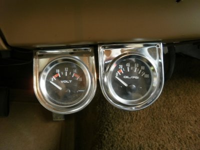

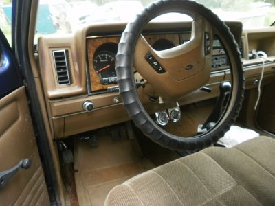

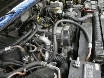

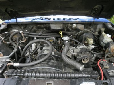

Well its not a perfect setup since this was my first real project vehicle. Still have some little details to fix under the hood but you can still get the general idea.
The original tach doesn't work because I would need a magnetic drive like what our usual IDIs use. Still not sure what to do about that. I have seen some OEM diesel rangers that had tachometers, but so far haven't been able to find one so far. I added 2 auxiliary gauges since the original truck only had idiot lights for oil and alternater systems. Oil pressure idles at 80 PSI cold and can peg the gauge if you rev it up cold. Warm it idles at 25 PSI and cruises around 50 +/- 10psi.
