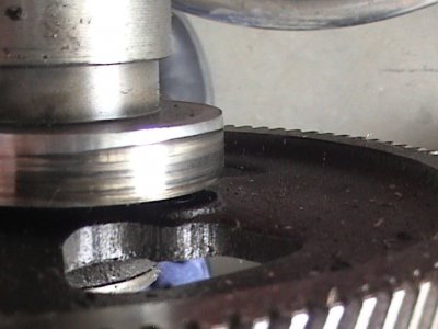

When you installed the mechanical pump, did you make sure the arm is under the cam shaft lobe? If the arm was a straight one then you have to tip the arm down, rotate the engine until the low side of the lobe is down on the bottom before installing. If it's the pump with the bent arm then it can go almost straight in. Here is a couple of pix showing how the high side is worn on this cam. Looks real bad but it's only about .025 thousandths.
