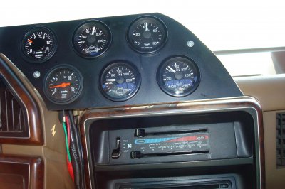

682
My rig runs about the same temp on coolant as the oil.. I installed a temp sender in my oil pan so I could track the oil temps. Now it will climb up when hauling or pulling a grade well above the coolant temps. But when the strain is off the engine things return to normal.
That's about what mine did. Like I said, about 185 was normal for a fully warmed engine with a light to moderate load. And it was sump temp, too.
