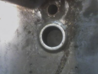

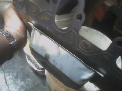

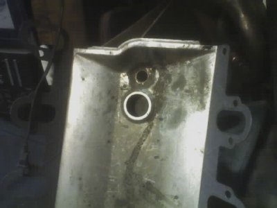

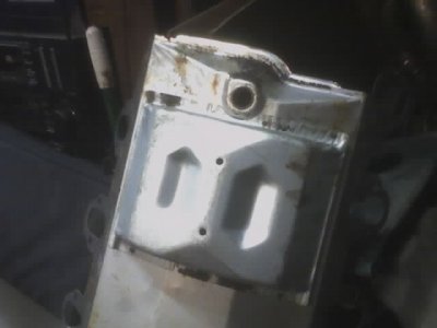

its a good thing I brought my pic CD with me. one more time guys....
you're looking at a section that has three layers. you see the top and the bottom easily. the second layer is visible throught he hole. the thin slot on the side is where the vapors is drawn into the baffling. the holes at the bottom is for the oil drainback that is condensed from the vapors. note the slot is at a higher point than the CDR hole. Note the stock drainback holes are less than a 1/4". without swisscheesing the second layer the drainback oil must fight a uphill battle or wait for a hard corner in order to get to the holes in the third layer.
my suggestion is to punch holes with max prejudice in the second layer so its easier for the oil to get to the third layer. IF you haven't installed the turkey pan yet, punch holes or enlarge the ones already existing.
oh yea, by you're punching holes not drilling. by punching holes you're not introducing metal debris just forcing open holes.

374
Calvin's pictures do tell the story, but only that version of it. There have been different revisions to this part of the valley pan over the years, and the one I put in the Moose Truck did not need any holes in it. The opening near the top of the baffle was larger than the one in Calvin's picture, and there were I believe 3 holes in the bottom. Since you've already got it all together, I'd let it ride and see what happens. Worse case, you'll have a mess and an opportunity to clean it up when you take the turbo off to punch the holes. :puke:
