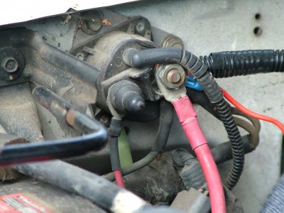

The starter solenoid you're looking for is on the passenger side fender. Not sure what the second one there is on your truck.
Here is a picture of mine, on a '92 CCLB. It should be close to the same. Mine will have 1 or 2 extra cables.

Yep, got one of those, and another one wired to it. I'm not looking at it right now, but I believe the load circuit is wired together in series. I don't know about the relay circuit.
I'll take a pic and post it later.
