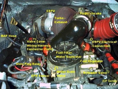

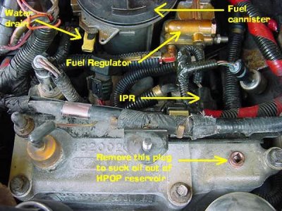

The oil in the "Upper galley" as you call it, gets pumped to the injectors and is used to push the plunger that injects the fuel. After that, the oil is squirted out of the injector and drains back into the oil pan. The guy on that web site acts like it's a closed system, with it's own oil.... It's not. The "Upper galley" actually gets it's oil from the low pressure oil pump, which is the same pump that lubes the rest of the engine.
338
New 1995 F-250 Powerstroke
Now Kevin a 95 is not new. Just kidding.:D :rolleyes:
Here is something that may help you tho pics below.. There is only a pint of oil in the HPOP reservoir, maybe a pint in the rest of the system = 1 Qt. total.
