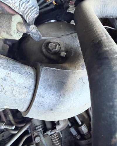

Thank you both gentlemen! I sprayed it with pb blaster to soak, what’s the chances of busting the aluminum turbo hat if it is corroded?
15,051
14,149
I've never tried to remove one, but I'd guess that you'll round off the head of the plug before you break the hat.
4,209
4,793
Yep just an aluminum plug. It should come out. If memory serves, it is 1/8 npt

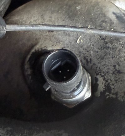

Well getting the plug out was not a problem, but the boost sensor will not fit in that area to tighten down. The base will not fit.
15,051
14,149
If you insist on using that sender, you can remove the hat and drill and tap it to 1/4" NPT or whatever size it is.
