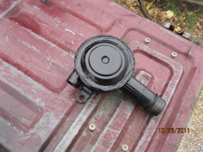

Opened up cdr cut center tube and welded it on side put a plug in hole going to intake put cover back on reinstaled added hose. There is a photo of my colant filter added by mistake. sorry.

Not sure if I follow you... You added a second pipe to vent it outside rather than to the intake? It's gonna get oily back there ;Really

i was thinkin that too but then :eek: light bulb oil catch can from ebay sealed tank they are awful pretty :sly then u could just drain it and no mess;Sweet

i think i read you could delete the cdr and run a velocity tube like a semi to keep all that stuff out of thee engine and you just block off the intake where it plugged in. im not sayin for sure though i could have not read it right and totally missed the point correct me if wrong please

I cut the tube that goes into the intake and plugged it , I just by passed the intake, I think that with the vent tube mounted toward the top it will let any oil that accumalates drain back into block.
