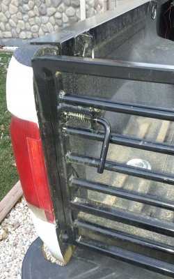

Took these for the OP now.
I'm very pleased with how mine turned out. I specifically had it designed w/ a very low "V" as I didn't want to have to drop my tailgate to hook up to my 5th wheel w/ a gooseneck adapter and/or have to jack the front end up super high to get out from under it.
Only thing I'd do different (which I am now) is have the tail gate itself coated in bed liner. I had it painted in an auto paint and it's extremely slippery when wet.
* sorry for the crappy photos, photobucket is annoying me and I can't load them there for some reason.......:dunno

Ah... yours was the one I was thinking of, did you just pull the latch studs out of the bed and use those holes to catch your spring latches or is there more there than meets the eye?
I appreciate the photos and advice everyone.
yea latch studs pulled. I re-used the tailgate cables as well for this tail gate. Love my tailgate; it's stronger than a stock tailgate (way stronger than the 5th wheel tailgates you can buy too) and it's super easy to lift and latch. I've not put my stock tailgate back on the pickup since this was made this summer and I haven't any plans to put it back on.

Have any more pics of your tailgate, specifically how it mounts to the lower portion of the bed? I'm curious as i need a new tailgate and i'd like to mount my spare 37" tire back there and have it swing like a TireGate but they are discontinued for our trucks.
I can take some for you tomorrow under daylight. Mine connects via the stock dog ears or whatever they are called (old man moment right now) :rotflmao
btw, anyone that wants one just like mine, my welder buddy that made mine is looking for work right now. Could probably get an identical gate for $350'ish from him.
