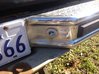

I went to get my truck inspected and it only failed 1 thing, the license plate light. After thinking I could just replace the bulb I ended having to replace the whole housing. I am pretty sure its not factory as I ended up using a universal license plate light from Advanced Auto http://shop.advanceautoparts.com/p/...151/17190412-P?searchTerm=license+plate+lamps
And after hooking it up it still doesnt work. I dont remember it ever working actually. But what I need to know is what does the factory license plate light housing look like (Was there one from the factory?), how does it connect and where do I find one (LMC Truck does not list it and neither did Advanced nor Rock Auto)? Are there better options for lighting there? Should I get a 2 wire light housing? LED options?
I seen this and thought it might be cool to use https://www.superbrightleds.com/mor...re-led-license-plate-bolt/1685/#/attributes/1
If anyone can just take a pic of their factory setup that would be a great help.

Here's the factory light from a 86
The 85 the Po just spiced in a cheapo light.

Part # 36-4505 at LMC
Interesting. It's the exact same thing I have. Although in the notes it says it's for the replacement bumper. I'm gonna get a test light and see if I can figure it out. If not then to the shop it goes. I'm not good at the electronics at all.

For what it's worth, I have the same assembly on my truck. I don't know why LMC lists it as being for a replacement bumper, because my housings have OEM Ford part numbers. I've seen them in painted silver, painted black, and chrome...I used to have painted silver, and snagged a chrome set from an Exploder that was being parted out.
With that having been said, you don't NEED the OEM assembly if an aftermarket one fits and lights up the license plate sufficiently. If the LED setup you linked to in your first post would work better, you can go that way, although I think the threaded part is much smaller than the hole in your bumper (not 100% certain, though). Whatever works easiest, really.
As to why it isn't lighting up...just to cover all bases, are your other running lights operating normally? If not, it could be as simple as a blown fuse. If the other lights are working as they should, then you either have a bad ground, a bad socket, or the wire got cut. Especially if you launch boats and the bumper might have been immersed in water, the terminals in the socket could be corroded to the point where you need a new socket.
I would take a voltmeter and see if you have 12 volts on the positive side of the socket, and continuity to the frame on the ground side of the socket, and go from there.
Hope this helps some..good luck!

Just for future reference, to replace the bulbs on the factory teardrop license, you have to reach inside/behind the bumper and twist the plug/connector and it will drop out. If the new one isn't working, just tap the wire for the other one as a power source.

1. As far as I know it should be. I had the truck running and the lights turned on.
2. Ground is good.
3. I am going to get a test light or multimeter to see what I can come up with. I wont be able to get to it until Saturday though.
