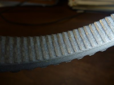

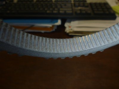

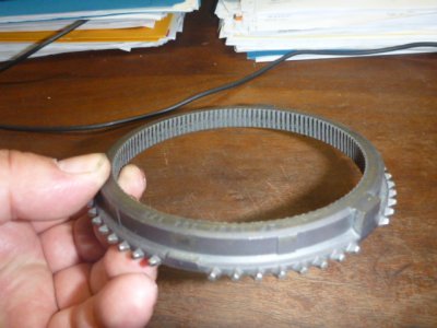

so AL...what is it? between post #17 and #32 it's either damn the torpedoes or use caution accordingly? imho, it sounds like more you're talking out of both corners of your mouth.;Sweet
I'm all for a educated operator. understand what you have and use it accordingly.
I have no problem floating gears. Everyone should know how to do it when the situation calls for it. In the event of clutch hydraulic system failure, or throwout bearing failure, floating gears is a solution in "getting home"
Now here's the reason why floating gears should be done sparingly.
note the first pic. the syncros look like any other. but the second and third pics show the backside of the syncro where the friction material was supposed t be at. a healthy friction ring will have raised lines of sintered metal that has been electro deposited onto the inside of the ring. the metal is no different from brake friction material and it doesn't have a unlimited wear as the last two pics hold in evidence. it is true the exact length of time needed to wear the material off is unknown but it doesn't take a genius to know the unrestricted use of floating gears won't forestall matters. read up and make your own decisions.

K here is where I am, I have no way of proving that floating is NOT going to hurt the transmission, however showing pictures of a worn syncro does not convince me it does either. As I said, unless the transmission is floated from day one all it's life..not passed down from owner to owner, we just cannot tell 100%
My theory if you CAN float and want to do it, being able to should be a priorty skill to attain for those JUST in CASE moments. Hell I did it yesterday in the ranger for shitzngigglz just to see if I could, ya it's tricky, however not impossible.
If people want to float them cause they can do it and do it knowing that there could be potential dangers.
However I choose to drive is my personal business, and practicing clutchless is important to me enough to get good at it and maintain that skill. When I got my truck, it had a bad 3rd gear so I would double clutch all the time and some times it would take and others it would not. That trans was worn out and likely NOT due to shifting without a clutch, however being the second owner I've no way to tell how it was driven.

I see the wear and I'll reiterate that we have no way of knowing if the wear is from straight clutchless shifting the entire life of transmission or normal wear, or faulty part etc?

Not sure why this has dragged out into such a long winded discussion, it seems pretty clear cut to me.
Assuming you can perfectly match rpms with the trans in neutral and no pressure on the shifter then slide it gently into gear, then no there *shouldn't* be any syncro wear. Problem is it's very hard to get this perfect in the real world. Anytime there's any pressure on the shifter and the gears are turning at different speeds there *will* be wear on the syncros. How much is going to depend on how much pressure and how much speed difference.
Remember that you've got something like a 30+:1 lever arm (estimating) on the shifter - that is 5 lb of force on the shifter (which seems reasonable for someone lightly pushing it in) equates to roughly 150 lb of force pushing the synchos together.
The other potential downside of clutchless shifting is that you have no shock cushioning - even if it's within 10 rpm, when that gear engages you're not locking everything together which means you're more or less instantly changing the speed of one or the other side of the gear train to match which is quite a lot of momentum.
That being said, I don't disagree that driving with out a clutch is a highly useful skill to have and good to practice enough to know you can if you needed too.
I wouldn't recommend driving that way all the time though - first of all it's a pain (at least to me), and then there's too much risk of wear/damage for what benefit? They designed the system with a clutch for a reason, and every reference I've seen says to shift that way - makes sense that to use the system the way it's designed.
Personally I double clutch 95% of the time - I feel like this makes things smoother and minimizes wear.
Given how long these units last with people abusing the heck out of them, I don't think there's any reason to really worry *that* much about wearing them out.
