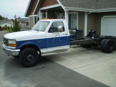

Is your truck an "f-superduty" (aka f450) or an f-250 or f350?

what the truck? 93 f superduty
Its a Super duty (450) that was sold chasis and cab Ill insert a pick
