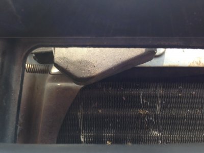

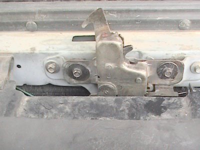

I had he same problem on my 92. The release cable became unhooked from the latch. Your cable may have broke. As said, you have to reach thru the grill and push on the little finger while someone holds down the hood and then lift it. Did it by myself, but it's a ***** to do that. There is a thread about it, can't find it. But pics might help ya. In the 1st pic, underneath and to the left of the little cable is like a finger, you have to push it to the right, then lift the hood up to the safety position. The second pic shows the shape of the finger. The 3rd pic I tried to draw a red circle around where to the left is the finger.
