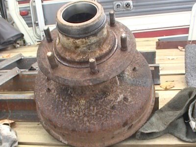

pretty damn solid just a piece of wood. Its dark out now so im done for today guess tomarrow ill freeze the studs, torch the assemblys, and hope for the best

wood might be the problem i would have put it on the concrete parking lot and let her have it with the bfh

That will heat a little faster but not much difference on steel this thick. Btw, why do You use a punch, can't You hit it straight with the 2 pound hammer if it is off the truck?

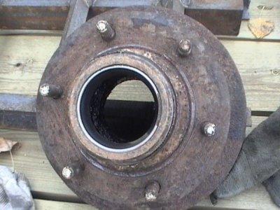

And I need the punch because you have to drive the studs in from the back of the rotor so they stick out of the hub, and the area of the rotor they are in is recessed, So I cant just hit it with a hammer.
I wonder if all 3/4 ton truck are like this or just Fords. At least the half ton chevys did away with this nonsense a long time ago.
There is definently no shortage of manpower going into this hammering too, thats for sure.
What a nightmare this job turned out to be

BFH, heat that hub n such in the oven 500 degrees freeze the studs, only take out a couple at a time and pound em in or go to diesel shop and get them pressed in...or the new rotor has the wrong hole diameter for the studs to pass...can u measure the old one to the new one?

Ok, boys, here's the deal. Unless that hub has some real good support under it, you can beat the stud with a building and it isn't going in.
Try this: Get a stack of washers and put a bunch of oil or light grease on them. Turn the lug nut around backwards. Put the stud through the hub stud hole and oil the threads. Stack the washers up about 1/2 inch on the stud (on the wheel side) and thread the lug nut onto the stud. Now use a socket or end wrench to tighten the lug nut on the stud, pulling the stud onto the hub. Works every time, no beating necessary.
Or get a bigger hammer and wail away.

Instead of using a punch, which stings the hand. Use the small ballpeen hammer you were using to drive the stud, place that on the stud and hit it with the BFH, the wood handle don't sting as much.
Just replaced 12 studs, ballpeen hammer like said and 4 lb hammer to hit, 15 minutes all out, 20 minutes all 12 in.
