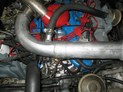

Cranked her up last night, started with no problem, sounds great.
Test drive tonight and then some pics, it not only sounds good but it's pruddy too. ;Sweet
Timthetoolman
Jul 20, 2006
271
Dayton, Tn.
Can't believe how much power this thing has hittin on all 8.
Hope it last, just sooooooo much more power.
Of course I did turn the pump up one more flat, youknow while I had it off in front of me. :D

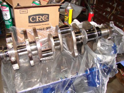

Cool, thanks for the photos. I was wondering what my IDI looked like. I wouild still llike to see what the rods and crank look like on these things. I have just read about them, never seen the inside of this awsome bod boy engine. I like having a better understanding of what I have.

typ4
Dec 24, 2005
9,131
1,431
Newberg,OR
Thanks again.
Marq
here is a crank pic

Nice setup. How long have you been working on it....
It has taken me about three weeks to do these heads, pull them off, order parts, wait on machine shop, keep wife off back doing stuff with her, too hot, to tired.
The IJ pump is about a year old, the injectors are two years old (poped tested them while off, 1800 pop) pump turned wide open and back a half a flat, running on my homemade B-100. I pull a 13,000 pound fiver.
Can't wait to put a new load behind her now :hail

The 90 degree bend is one of my old over the axle three inch pipes, cut it, added another piece of pipe and had my muffler guy swedge it out to four inch to fit the air cleaner from O'Rileys.
The coupler is a stainless band with rubber inside, Ace hardware has these to couple pvc pipes.
