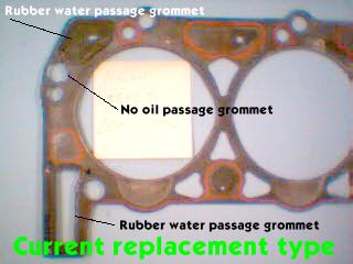

Well, I do still have both old headgaskets. Turns out, according to Mel's article, the driver's side is original or pre-88, and the passenger side (the real leaker) is unlike any in his pictures but identicle to the ones I have to replace them with. It appears that, according to Mel's pics, Ford gaskets come with sealant. At least those designs pictured. The ones I have are slightly different. No 'triangles' around the fire ring (enlarged bolt holes?).

Yes the new ones have sealant already applied.My 1993(went into a 1994 truck) original gaskets were alot different than that picture.The big triangles were metal inserts and the entire top and bottom of the gasket has a silver sealant stuff that kinda squishes out only during torquing.Let me tell ya this,that stuff is a bear to clean off after it has sat up for over 10 years.But the all the new IDI gaskets from Felpro will have the silver sealant stuff on it since all IDI gaskets now are Turbo spec.

Thanks!! :) That 'silver stuff' is what I am used to seeing on a head gasket, and is what I have now. It was due to the fact that the one had rtv'ish sealant on it, I saw Mel's photos and I know that many gaskets are coming with rtv on them I was starting to wonder what I got...
