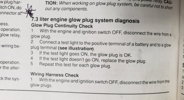

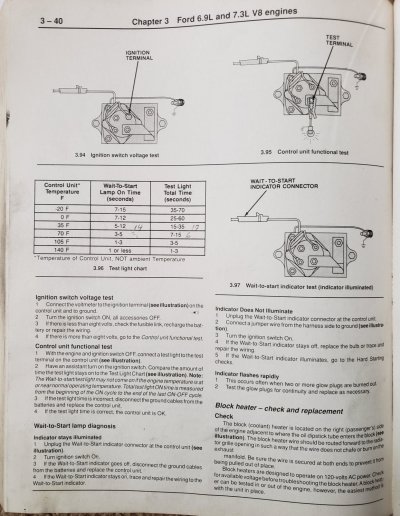

Owned my 1988 F250 7.3 since new.
Over the decades I've diagnosed and repaired the usual 'rapid clicking' issue from a bad GP or a few.
Last year I diagnosed and replaced the faulty GP Controller with another GP Controller unit from Ford.
Now what's happening...
#1 sometimes getting the rapid short GP clicking/cycling.
#2 sometimes no WTS light or GP burn at all.
#3 sometimes it works as should.
I just went through all steps on the GP diagnoses and everything checked to be ok.
#4 can the GP Controller intermediary act up before it fully fails?
* the current installed Ford GP Controller has another two year warranty... I can get another free. But again, every test in the book was a 'pass'.

But again, just the other day I performed all the steps to test the GP and Controller and everything passed.

Just curious 'if' you performed the test for the GP female ends as I did?
I can absolutely agree that resistance can build up in those little push-on plugs. I've always put a little dielectric grease in them to help make a better connection.
