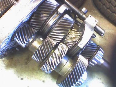

here's why.
he said third is going out. this is what happens when it does......
the trans is not a cheap proposition to rebuild either.
