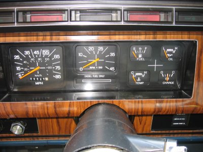

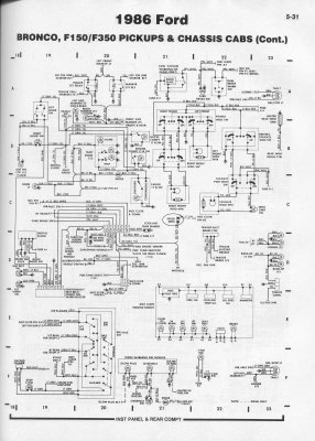

I'm in the process of adding a stock tach to my '84 that did not have one from the factory. So far, I've replaced the dash to a newer one with the tach, and found a gear cover with the tach sensor. So, my question is, what wires do I need to hook up to make it work? I've looked at this wiring diagram and I'm assuming that "speed sensor" (C-21) refers to engine speed (not MPH), right?
(BTW, I used an orange highlighter on the faded gauge needles and they look like new!) (I also found a way to make the dash brighter at night)

Just be real carefull with the position of the IP gear when you swap cases. Yes, your assesment of the tach wiring is correct. A single wire to the tach, and the other sensor wire to ground is all it takes to make it work.

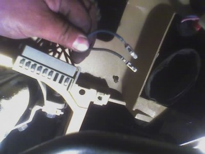

I've been stripping the wiring out of the 87-91's so the install will look "stock". there's two open slots on your cluster plug that takes the two wires. With your factory tach cluster, it's plug-n-play;Sweet

Just lucky. They were in pretty good shape to begin with. All I did was shine them up with tire foam ;Sweet
If you're gauge needles are faded pull the plastic cover off and do the ol' orange highlither pen on the needles. Makes them look new! :love:
Your truck is looking sweet BTW. Hopefully mine will look as nice one of these days.
