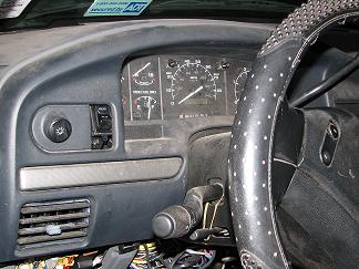

Hey h2odrx, Does yours look like mine in this picture?

Mine did the same thing. I also repaired as others have described with small black trim screws from the front side of the panel, but being picky about my truck I wasn't satisfied. I ended up buying a new dash trim panel from Ford to replace my old brittle one...
Ryan
How much did that cost you? I saw one for around 180, not sure exactly how much though.
It seems that NOS would be just as brittle, imho.. Do they still make new ones? Actually, I wonder if a complete dash can be obtained new? My dash mounting tabs on the top have all broken except for one that's left of center...:mad:
