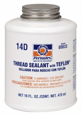

I don't use teflon tape on engines. Thats for plumbing. Get some of this.
