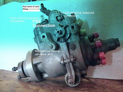

Your IP won't be the problem, pic below for connections. Why are you concerned about the wiring?
Thanks for the pic. I'm having trouble getting fuel to the IP - Whenever I've lost prime before, I bleed the air out of the fuel filter, crank the starter for about 15 seconds, let it cool, crank again for 15 seconds, let it cool, hit the glow plugs and I'm off and running. I've killed the batteries twice now trying to get fuel back to the injectors. My first thought was the FSS, needed a sanity check on whether I was getting power to the right terminal.
