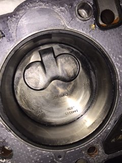

I had a tick as well it turned out to be a beat up piston top and a cracked cylinder yay! and I fixed it all too!
Took a few tries to get out all the kinks :backoff

Cracked cylinder 3rd one back right side, some tiny piece of metal fell into the intake and munched my 7000 mile old IDI and I did it all over again for the 3rd time.

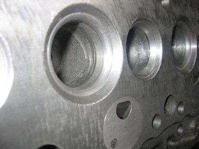

I went by the machine shop yesterday to drop off valve stem seals. So here's the scoop.
They tore down & hot tanked short block. They checked rod & main bearings, crankshaft, all rods & wrist pins, bores, pistons, etc. & everything is within spec. He did mention that the rings didn't have much tension & will be honing out cylinders & installing new rings when he puts it back together.
Now the heads are another story. Almost every valve seat has a crack in it that extends into combustion area on head, valves were previously ground down too much & have a knife edge on them. Some of the exhaust valves are starting to mushroom. All 8 precups cracked. All guides are shot & have side-side play.
When the previous guy took .020 off, that was too much material, making the seats & valves way too thin. Now I can say that the egts did get high, but I don't think this should have been the result. I got the egts high previously with old engine & there wasn't any damage to heads.
So what I have now are two 90 lb boat anchors. I have one spare head that the shop is going to check out on Monday but am on the lookout for another. Fun isn't it.

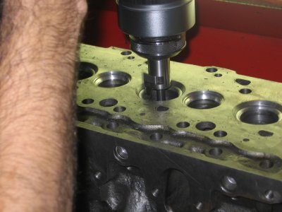

Got a call from machine shop today. Turns out the other 2 heads are also cracked like the other 3, but not as bad. He said that he is able to fix cracks by drilling & pinning them. So, I'm going to let him do that. I'm tired of driving all around picking up these heads that are all cracked anyways. I even talked to Mel who said it's very rare to come by a set that isn't cracked.
Heads will get cleaned up & milled, new exhaust & intake valves, new precups, new guides, the works.
While short block is apart, I'm having them install all new rings, bearings & bushings. They are also going to polish crank & hone cylinders for new rings going in. Owner said the bearing kit that the previous rebuilder used was an overseas kit that wasn't reputable, so out they come & in with the new made in USA.

Here are the cylinder heads. I had machine shop install all new pre-cups, guides, valves, seals, the works. Re-used the comp 910 springs. These cylinder heads also had a few minor cracks in them, so I had owner lock & stitch all cracks before calling them good. Made double sure that he kept everything within spec & felt that they did an excellent job with them. Hell, they even bagged & painted them before I picked them up ;Sweet!
