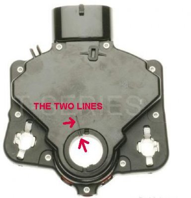

Would this be listed as just the Nuetral safety switch at the parts stores @trackspeeder by chance. Im not showing a listing at oriellys for Transmission range sensor but showing a Neutral safety switch which looks identical
what is at oriellys

the teca relay is bad as indicated by a dim od light and high gear starts.
the tach sensor is bad as indicated by a 0 reading at idle. ----- change the bad relay before replacing this! if the tach then works properly,then no need to replace.....couple bucks vs 80$! and you know the relay is faulty anyway.
the solenoid pack has failed as indicated by a failed seal.
the range sensor (formally known as MLPS) has failed due to the dropping in N while driving.

yeah,often you need to ask parts counters for a neutral safety switch for the MLPS/range sensor to come up in the computers.
so long as the part looks like the one iv attached.

I so much appreciate all of you one day I hope to buy all of you either a six-pack of beer or lunch your choice LOL I'm at O'Reilly's now bout to pick up a neutral safety switch everything that you just listed has been replaced and fixed and it drove so good this morning on my test drive until the SOB kept popping out of gear and wouldn't shift I thought it was the end of the world I'm really and truly hoping that this safety switch will allow me to make some money!

yeah that's very scary when a range sensor fails because you would think it was mechanical.very frightening.
rest assured,trackspeeder got ya headed towards the cure with that one.;Sweet
on your way home,go easy.when you feel it go out of gear,manually shift it to N and roll to a stop then start out again.
letting it find it's way back in and bang is very nasty for it.just go easy.
