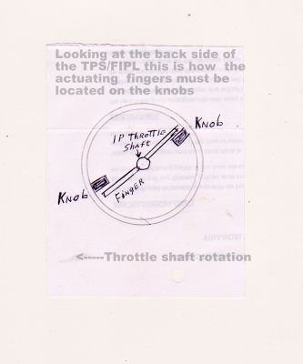

If you replace the TPS/FIPL be sure the driving fingers are like the pic below when you mount the new one.
