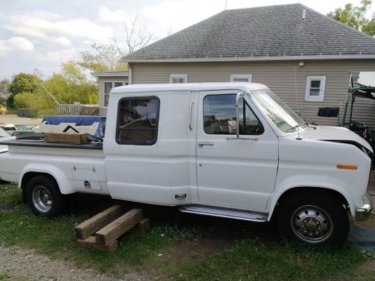

After sitting overtime it won't start without juice, then its good for 4-5hrs. Replaced leaky water seperator still the same. Put in a check valve worse. Can hear intake fuel pump ,pulled fuse & checked mechanical fuel pump WORKING. Won't start unless juiced. Help me. Thank you all
